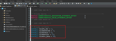

I have just downloaded and installed the new version 2.0.0 of the IDE and the MX software (since it is no longer integrated). I was working on a project based on the STM32WB5MMG, and everything was working correctly with IDE version 1.19.0 and STM32Cube FW_WB V1.23.0.
After opening the project and regenerating the code with the new IDE version and STM32Cube FW_WB V1.24.0, I noticed some issues:
/* USER CODE BEGIN PM */
/* USER CODE END PM */
uint16_t SizeFw_Ver = 1;
uint16_t SizeDatetime = 7;
uint16_t SizeStatus = 6;
uint16_t SizeMonitor = 15;
uint16_t SizeEnv_Data = 90;
uint16_t SizeEnv_Data = 90;2. it doesn't generate any local functions in custom_app.c:

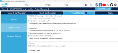

2026-01-14 3:27 AM - edited 2026-01-14 3:27 AM
here it is. I see that the problem happened if I click on the "Migrate" option.
Thanks
2026-01-19 2:05 AM
Hello @matteverze
As discussed, I was not able to reproduce the first behavior even if I uncheck "Delete previously generated files".
The second issue is confirmed and a child ticked is reported to the dedicated team. (Ticket Number: 225397)
