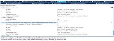

All related to the deadtime settings are disabled, but the Set Source of Output 2 can't be set up. It keeps constant 0, and says the deadtime is enabled? why???

All settings related to dead-time are disabled, but the Set Source for Output 2 still cannot be configured. It stays at 0 and the tool says that dead-time insertion is enabled. Why?

Thanks. The MCU I’m using is the STM32G474RET6. Sorry for not mentioning it earlier.

Thank you for bringing this issue to our attention.
A ticket  222461 has been escalated to the development team for further investigation and resolution.
