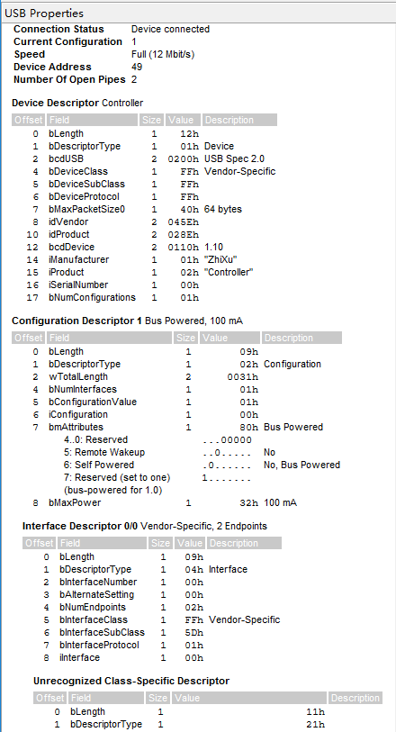

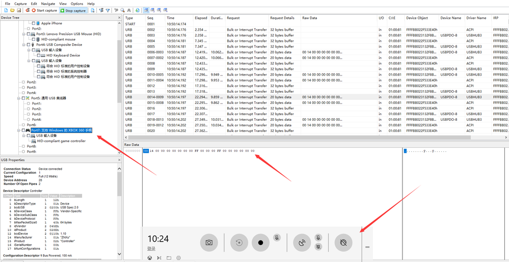

But the PC side is driver-free.
The PC can directly recognize the gamepad.
Click the home button to bring up the interface.
Data can be read using the USBlyzer.

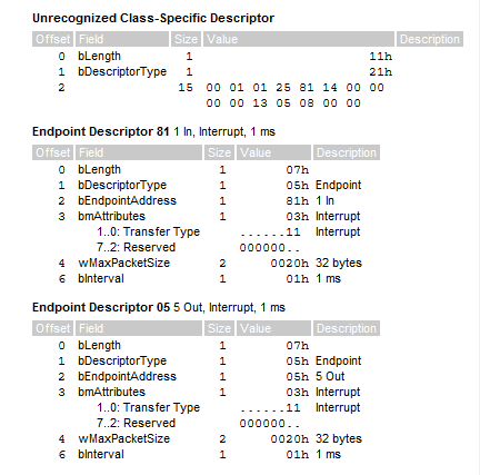

Modern Windows download drivers through Internet without letting you know.

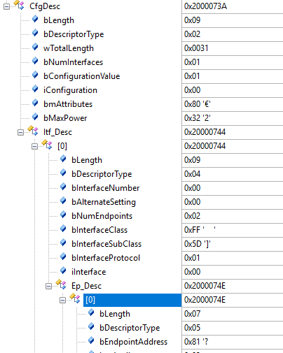

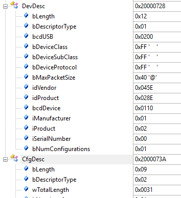

Post the whole configuration descriptor.
0690X000006D8DFQA0.pngChange the code and get the description:
waclawek.jan
Super User
There is only one interface, (as bNumInterfaces = 1 in CfgDesc ) and that is bInterfaceClass=0xFF = Vendor.
So it's as I've written above: it's not a HID class, it's a vendor-defined device, which works only with vendor-provided drivers.
