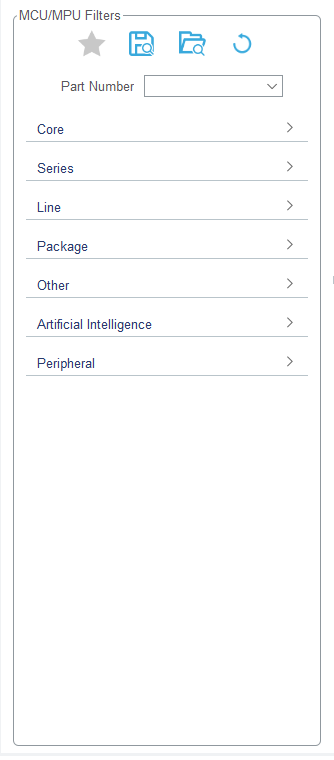

Is it possibile to add four or more filters ? thanks in advance

Hello FBern.2,
Your question doesn't seem very clear to me, but if you are asking about MCU/MPU Filters panel, it is possible to check more than four criteria.
