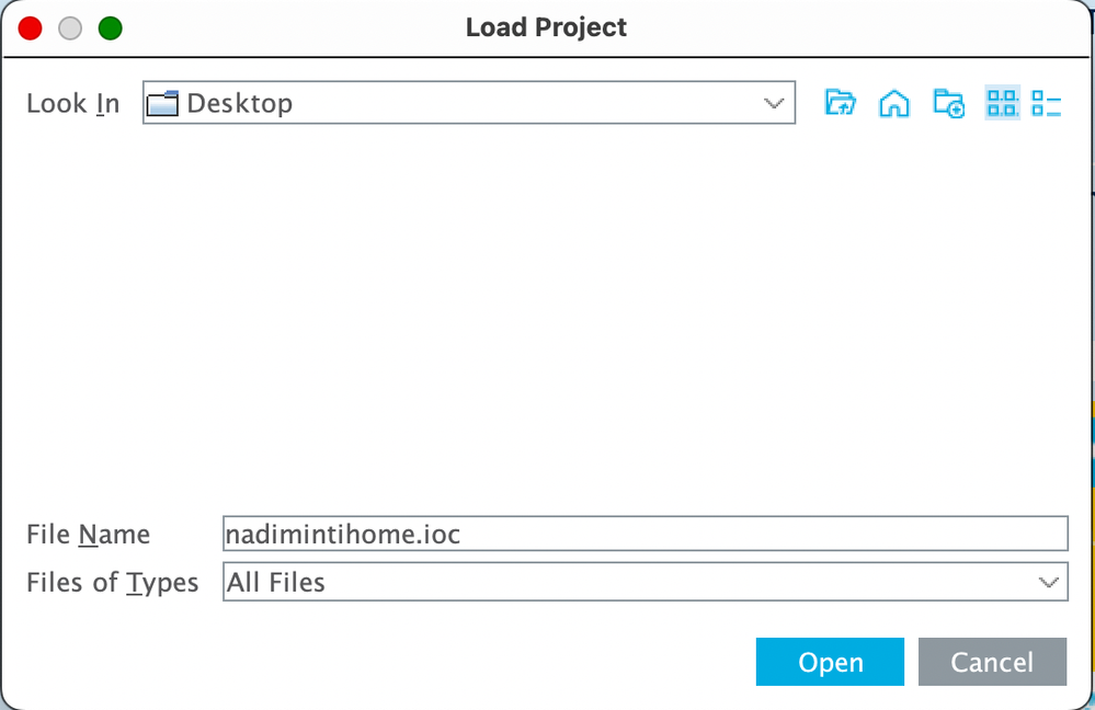

2023-01-24 10:55 PM
The same happens when I try to open a project from the 'Other Projects -> Open' button.

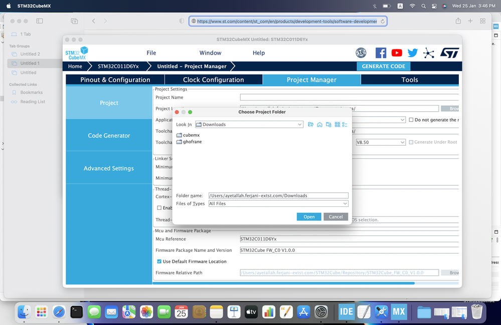

2023-01-25 5:42 AM
Hi @Ghofrane GSOURI ,
Thanks for the reply. I have updated CubeMX and it is still the same. (screenshot attached).

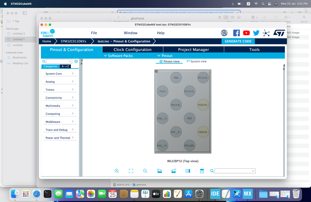

2023-01-25 7:05 AM
Hello @MJ042
Actually I tried to reproduce the issue using the latest version Cubemx 6.7.0 but it works fine from my side .
I create a project I save it at a specific location that I choose
I changed the project name using the "save as "

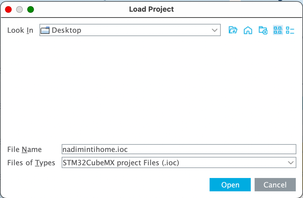

2023-02-09 1:30 AM
Thanks for keeping me posted.
While 'Save As' works as such, the folder structure still doesn't appear in the browse window either while opening or saving.
I think this is specific to the MAC OS version only. I've shifted to windows and it works fine.
