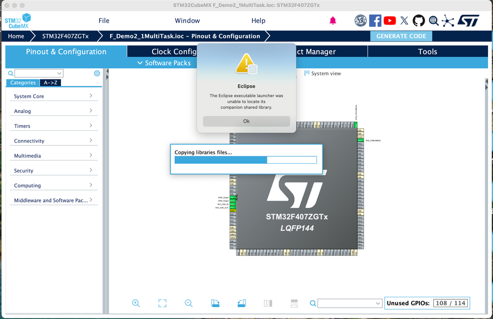

I have installed STM32 CubeMX on a Mac and I get the following error when trying to generate code:
The Eclipse executable launcher was unable to locate its companion shared library.截屏2024-12-01 18.42.46.png

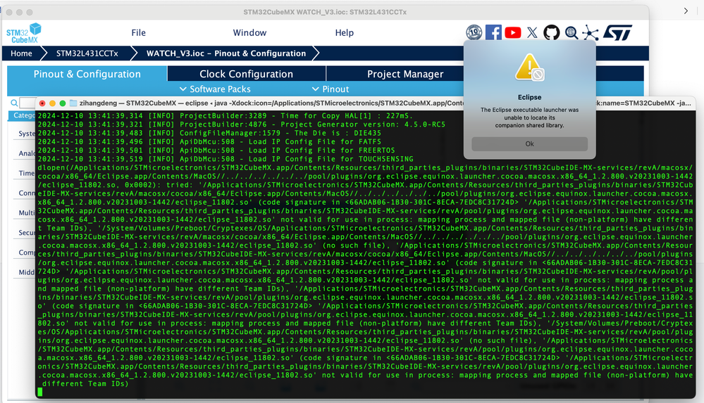

The problem has not been solved. The following is the log when the problem occurred. Please check how to solve it.
