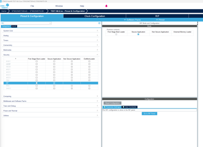

Hello @Z-YF ,
In order to build successfully your project, I suggest that you enable the RIF peripheral on STM32CubeMX then generate the code.
I will be waiting for your feedback.
Thanks.
Mahmoud

2025-05-07 5:56 AM - edited 2025-05-07 5:57 AM
Hello @Z-YF ,
Thanks.
Mahmoud
2025-05-09 5:43 AM
Yes, thank you for your time. Now I can successfully use the LTDC and DCMIPP. :)
