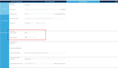

2024-12-19 1:02 AM - edited 2024-12-20 12:11 AM
Hello @Nick Alexeev
In order to change the _Min_Stack_Size and _Min_Heap_Size using GUI fields.
just go to Project manager -->project
Unfortunately, for the meantime, there is a limitation in this option that has been tracked with internal ticket 197963.
THX
Ghofrane
