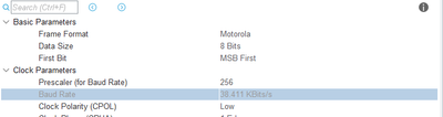

I think you can use PLL for this.
I had a trial and achieved 38.411Kb/s . I don't know if it does fit your expectation:
