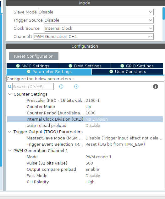

I'm trying to control a Servo motor (MG90S) using the STM32F767Zi by leveraging the TIM2 Channel 1 (PA0).
The Servo requires a 50Hz frequency (20ms) signal.
The APB1 bus gives TIM2 timer port 108MHz frequency.
The Servo is powered through a 5V port through STM and STM is powered through USB type B cable from my laptop.
I'm using the below calculations for PSC and ARR and have given a Duty Cycle of 2.5% - 12.5%. (0.5ms - 2.5ms)
My Timer_freq TIM2(APB1) is 108MHZ(108000000)
Required Frequency is 50Hz
i.e PSC*ARR = 108000000/50 == 2160000
PSC = 2160-1
ARR = 1000
Duty Cycle given is: (since ARR = 1000 i.e 100%)
TIM2->CCR1 = 25 (0 degrees - 2.5%)
TIM2->CCR1 = 125 (180 degrees - 12.5%)

}My servo is not responding.
I used the same calculations to control my servo with STM32f103 (Bluepill) and it worked fine.
I tried connecting the servo to an external power supply (ground being common between the Servo, STM32F7 and the power source) - Still no response from the Servo. Again, the Bluepill works with the same setup.
I have checked the 5V port of STM32F7 using a multimeter and it gives the correct voltage reading.
So, the next step that I’m planning to do is to check the signal port using an oscilloscope/logic analyzer. I’ll update on that soon.
It would be great if anyone can point out if I’m doing something wrong or help me with the right direction.

I'd divide down to 1 MHz (PSC of 108-1), giving a tick rate of 1us, and ARR of 20000-1 for 20 ms
Then CCRx would be in us, 1500 would be top-center (1.5ms)
The F7 chip doesn't have a 5V pin, the "signal" would be 3.3V CMOS levels, but should be sufficient. Validate signal with a scope.
