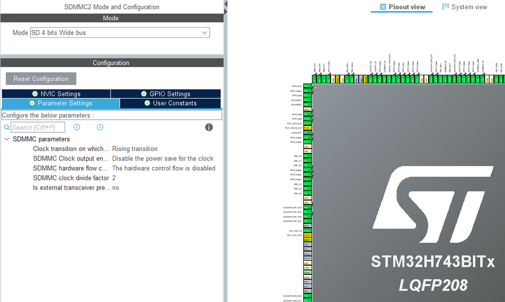

I have a custom board with an STM32H7. I configured SDMMC2 correctly on it.
As you can see there is no options for configuring DMA since it has an Internal (I)DMA.

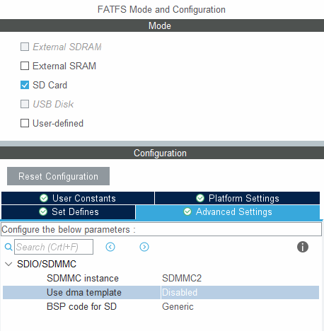

I have also added FATFS, as follows.
I managed to write/ready successfully to SD CARD mounted via FATFS. My problem arises when I enable the ‘Use DMA Template’. It is a must in order to later add FreeRTOS to the project.

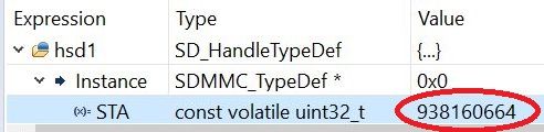

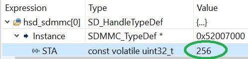

After hours of debugging I realized that:
Any help is highly appreciate it :folded_hands: .

I appreciate your follow-up. But, no, the solution provided did not solve my problem. I have tried the following.
I noticed that SDMMC2_IRQHandler() does get called but exits without calling BSP_SD_WriteCpltCallBack(). I get HAL_SD_ERROR_TX_UNDERRUN. I spent days debugging this and trying different configurations but with no luck!
