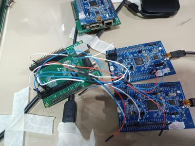

my observation: I took two STM32F407VGT6 microcontrollers and connect them the to same SDIO source it(setup) is not working when both boards are powered on but when USB and FATFS works fine seperatly the problem is in two pins (PC10 and PC11) D2 & D3 please give me solution for the following:
