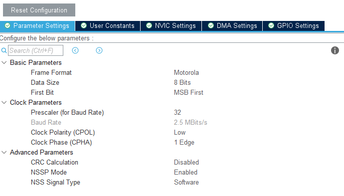

This is the setup i am using on cubeMX:
I used similar tutorials with the same steps in previous CubeIDE versions and on SWB4ST32 and it worked fine

@Community member, Make sure that the baudrate in the SPI config is respected and make sure the chip select is connected. Any feedback would be appreciated.
