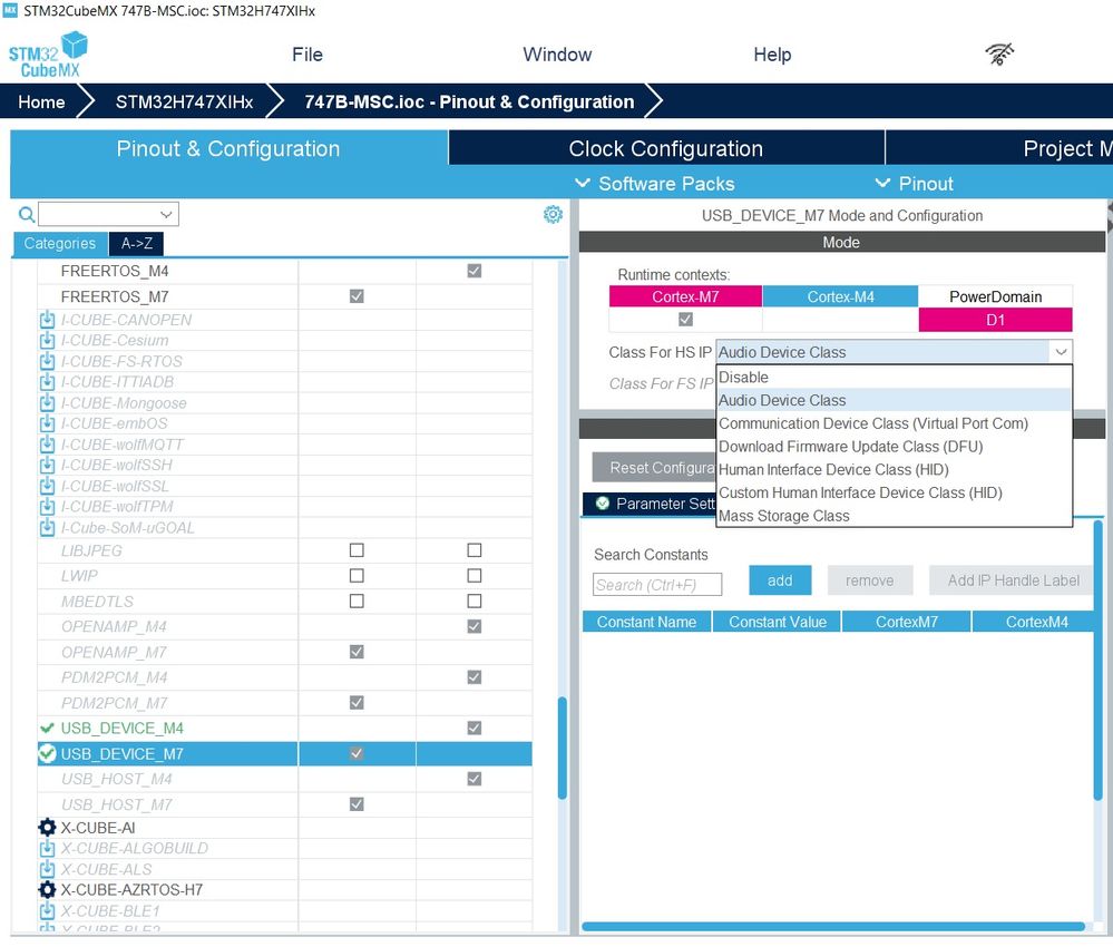

Another question are no UVC can select in the CubeMX USB class.
2024-12-11 2:37 AM
Unfortunately, Video Class is not supported on STM32H7 product. Your query has been submitted to dedicated team.
Internal ticket 198286 has been created to track the addition of this USB class to CubeMX on H7.
