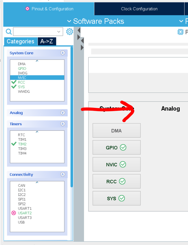

After creating a new project STM32CubeMX it automatically generates code. If I want to change any setting using STM32CubeMX how can it be restarted from within STM32CubeIDE ?
I ran STM32CubeMX by double-clicking the .ioc file, but STM32CubeMX does not show the configuration tabs. What is the proper way to rerun and reconfigure STM32CubeMX ?

There is still another vertical bar there. Drag it right.

It should show up when you double click the IOC. Maybe the panel is hidden or something. Show a screenshot.
If you generated it in standalone mode, you could just redo it there as well.

The tabs aren't missing, they're just collapsed. Drag the vertical bars away from each other to expand.
User code is preserved on regeneration as long as you have the checkbox marked. I'd back everything up beforehand if it were my project, however.

Thanks for the help. It's a shame that the panel is completely collapsed.
