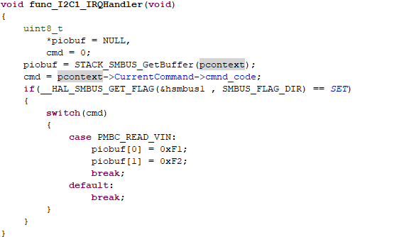

I am working on an experiment using the STM32G0B1 NUCLEO board to implement the PMBUS slave functionality with the SMBUS middleware.
According to AN4502, the buffer in SMBUS_StackHandleTypeDef *pStackContext is described as being used for IO. I have a question regarding handling master requests. When the master sends a command to read the input voltage, such as PMBC_READ_VIN (0x88), at what point should the application layer populate the buffer with the data so that the master receives the correct value?

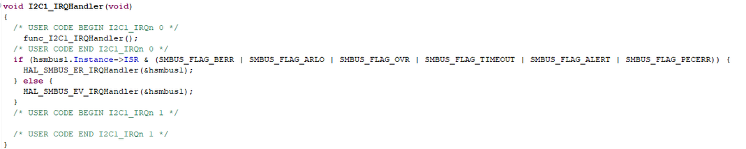

I solved this issue, for example:
