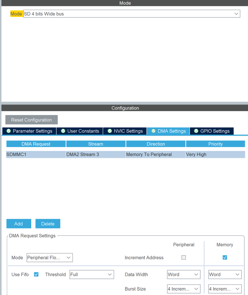

Hi everyone! I'm having some problems with DMA+SDMMC+FATFS.
The nonDMA version works succesfully. But when I want to use DMA I have problems.
My MCU - stm32F765vi. My peripherals initialization looks like

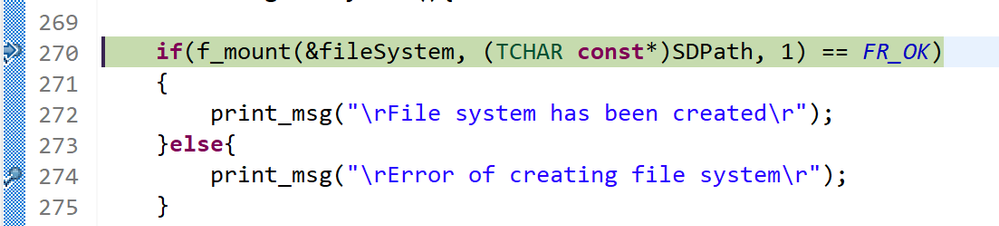

The problem is that f_mount returns an error that makes it impossible to work.

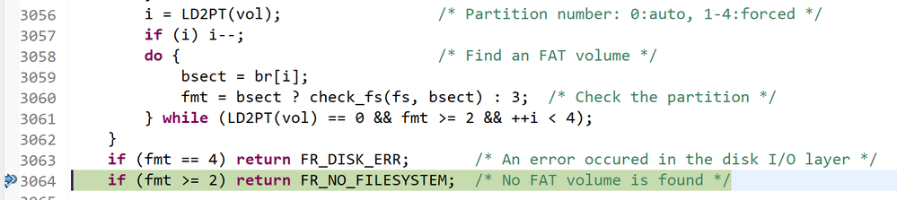

Going further, the find_volume function is called in the f_mount function. Then the code stops at this point, after which an error is returned.
Value of fmt = 3.

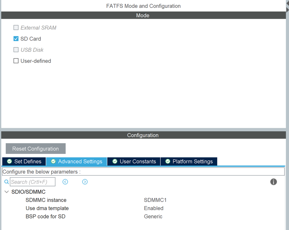

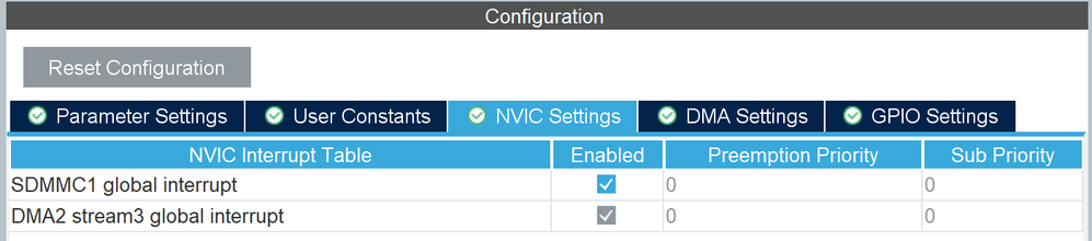

2022-03-10 10:33 PM
I'm new in programming on stm32. This is my pet project to improve my skills. Could you explain me in more detail how to make it work from the box?
I thought the problem was in the generated code that I can't change or in the init settings that I showed in the screenshots.
