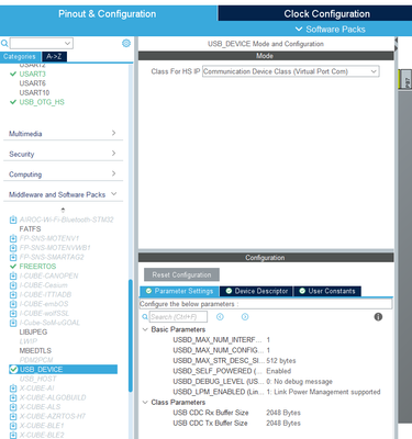

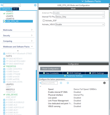

I use the CubeMX starting project with the NUCLEO-H723ZG and I only add the USB_OTG_HS as a Full Speed Device.
Then I add the middleware for the CDC using all default parameters.

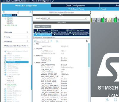

If I use the project at this point, the USB communication with the virtual comm port works flawlessly. However, it stops working when I add the middleware FreeRTOS with its default parameters

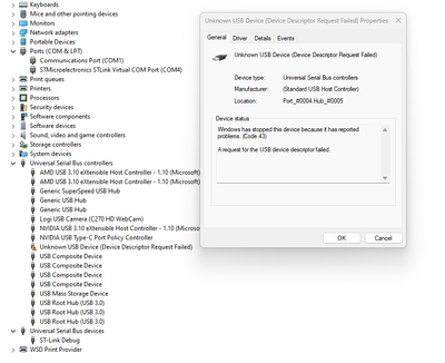

In Windows 11 Device Manager, I am getting the error were the USB descriptor failed (Code 43)

Now testing your project and I've reproduced the issue. It seems there is a hardfault with your Task RTOS configuration.
The first thing to thing about in that situation (in baremetal is OK, with RTOS: Hardfault) is the Task stack size.
Increasing the stack size from 128 to 256 makes the hardfault disappears.
Hope it does answer your question.
