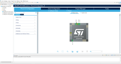

I upgraded STM32CubeIDE to 1.14.0 and then when I went to open an ioc file I got this message:
This project was setup with STM32CubeMX V6.9.2 using STMCube FW_G0 V1.6.1.
There are two options to proceed:
-Migrate:Migrate your project using the current STM32CubeMX version (6.10.0)
-Continue: Continue to stay compatible with the old STM32CubeMX version 6.9.2
I chose the 'Migrate' option, which was probably a mistake. Now when I try to open the ioc file it just goes blank. Any advice please?
ADDED LATER: In the meantime, I tried opening a different project, but selected the 'Continue' option. Again I got a blank tab when I tried to open the .ioc file

Hi STTwo-32, and thanks for replying so quickly. The file is attached

This is the .ioc file with the file extension changed because the forum software would not accept it with the .ioc extension. I got a big red warning. Please just change the extension back from .txt to .ioc

2023-12-08 12:25 AM
What is the current version of your installed STM32G0 FW ?
Have you tried to force the tool version by hand in the ioc file ? I know this is not always recommended and could be risky, but this could be worth trying...
2023-12-08 1:03 AM
Restarting PC - same problem.
Purged the STM32CubeIDE package from system and re-installed - same problem.
I'm puzzled by the message that said "This project was setup with STM32CubeMX V6.9.2 using STMCube FW_G0 V1.6.1" as this device is F411CEU6 not the G0 series. Is that a clue to the problem?
2023-12-08 1:05 AM
Hi Oscar. Thanks for replying.
Which line in the ioc file would need editing?
