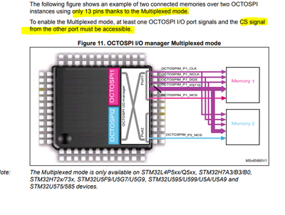

"no need for 2 ports, only one port is sufficient." => I mean only one data port. But we need two NCS: CS for port 1 and CS for port 2 as explained in the below figure from AN5050:

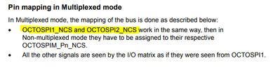

So, Multiplexed mode requires BOTH: OCTOSPIM_P2_NCS and OCTOSPIM_P1_NCS
as mentioned in the RM0468:
OCTOSPIn_NCS are not part of the multiplexing. Only OCTOSPIn_IOs, OCTOSPIn_DQS and OCTOSPIn_CLK / OCTOSPIn_NCLK are multiplexed.
Hope this answer your question.

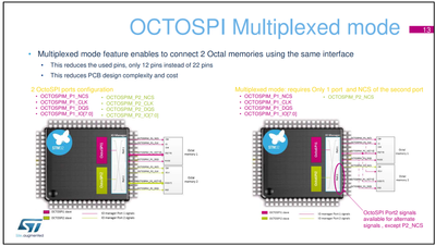

Yes I understand, only one dataport is needed which is the whole idea, but two NCS (Port 1+2) are needed, or have I missed something trivial? Picture to the right below.
A long shot, but what about connecting NCS1 to CS1 and then connecting a logical inverter to CS2 via NCS1? In that case, when NCS1/CS1 goes low CS2 automatically goes high and vice versa. In theory it would then give access to both memories in multiplexed mode using only NCS1.
