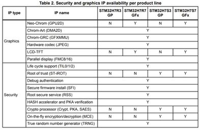

Hello @GeneralSyb and welcome to the ST Community :smiling_face_with_smiling_eyes:.
I think that we have no problem since the STM32H7S7I8T6 is the LQFP176 GFx package. The LQFP176 GP package is the STM32H7S3I8T6. So, in this case everything works fine.

Thank you for the quick response.
If S3 is the non-GFx pinout, wouldn't that make the footprint/symbol in the ST library and on mouser(I downloaded the kicad files from componentsearchengine via mouser) incorrect?
Hello @GeneralSyb
I confirm this issue on the Symbol side and I've reported internally for correction under internall ticket number 184071.
