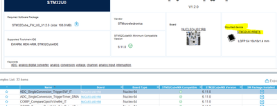

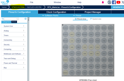

The MCU of NUCLEO-U031R8 is LQFP64. But if I import the example of NUCLEO-U031R8, STM32CubeMX shows it as UFBGA64.

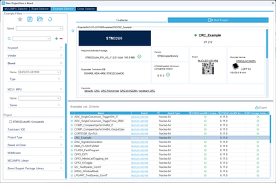

I am using the example of NUCLEO-U031R8, which is STM32U031R8T6. I attached a video of my operation.
Thanks.
Hi @Torris-Yin ,
I see the contradiction now.
For the selected project: the mounted device is STM32U031R8Tx (LQFP64 package).
But, when you open the project, it is mentioned STM32U031R8Ix (which is UFBGA64 package).
Thank you for rising this up.
I escalated this issue to our CubeMX team (via internal ticket number: 198841)
(PS: Internal ticket number is only for ST reference, not accessible outside of ST)
When your question is answered, please close this topic by clicking "Accept as Solution".
Thanks
Imen
