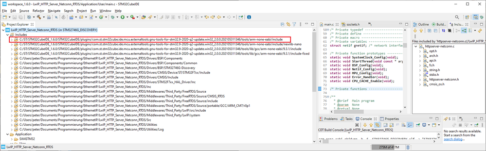

#include "task.h"and the in STM32CubeIDE project there are these includes:
Peter

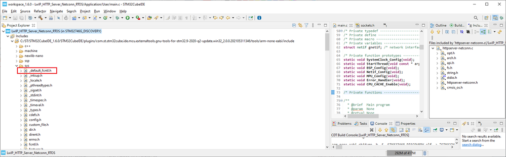

There for I had a deeper look there and have seen how the _default_fcntl.h gets incuded into my program. It comes via the includes in the project:
Please check this.
Kind regards Peter
2021-08-08 11:48 AM
Then ok, the _default_fcntl.h comes from the toolchain includes. Normally this is included via fcntl.h.
Just make sure that LwIP source files are cofigured so that fcntl.h from the toolchain gets included, and #ifndef O_NONBLOCK is false.
