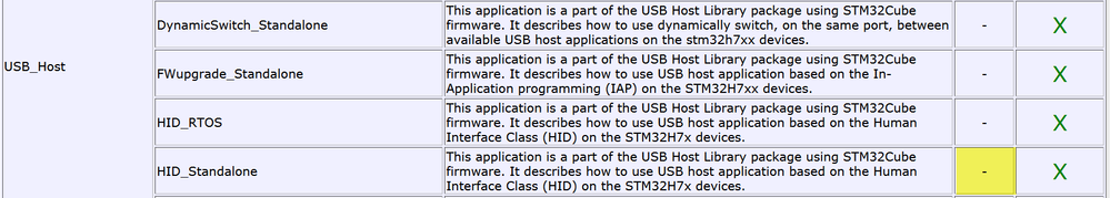

Have you seen this?
https://community.st.com/s/question/0D50X00009cd6whSAA/usb-hid-host-connect?
From the following document:
STM32CubeH7 Firmware Examples for STM32H7xx Series
The USB HOST HID IP is supported on the STM32H743I-EVAL but not on the NUCLEO-H743ZI so there is some minor difference to prevent the use of the same code run on the NUCLEO target.
2019-01-10 4:20 PM
Thanks for the hint Mon2.
I think that the NUCLEO-H743ZI board is capable to run an USB Host HID application. The problem is that ST examples use the LCD to show devices inputs and status. They should have done examples for the NUCLEO boards, where the device inputs (Keyboard or Mouse) is stored in a buffer.
