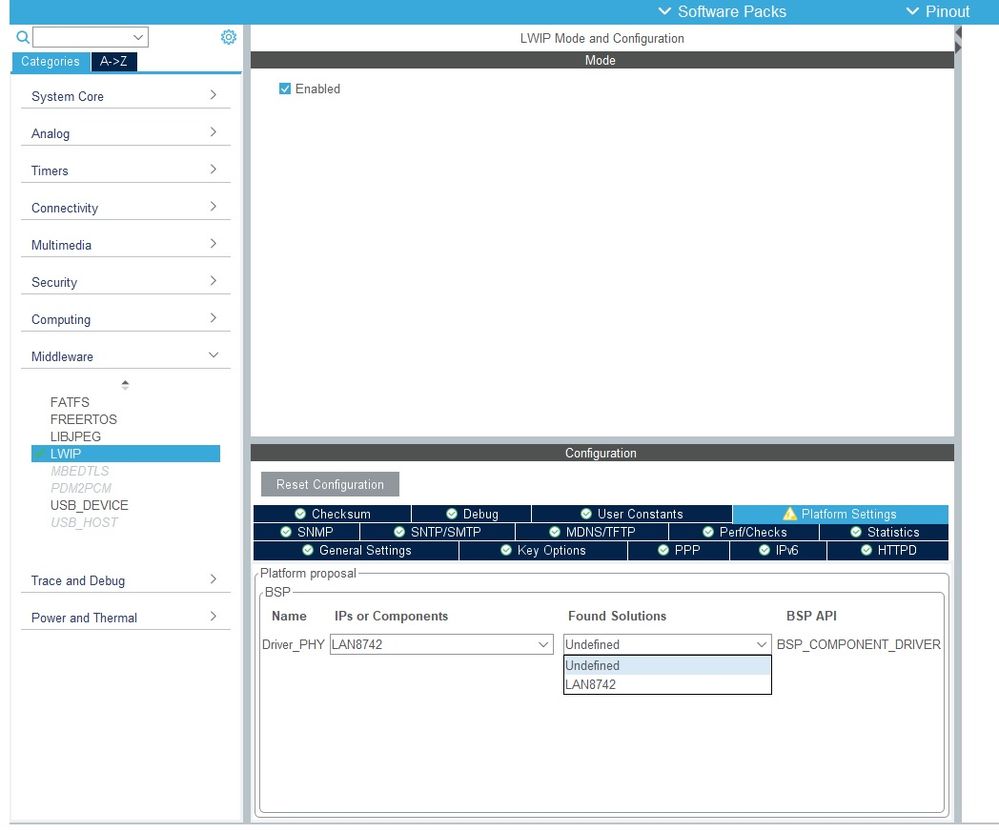

I have created a project as in the video (https://www.youtube.com/watch?v=PalTKoMf_Xo&t=276s), however in my case there is an extra tab as "Platform Settings" in Middlewares->LWIP and it gives warning. After that, I couldn't take an IP address from my modem. I used DHCP.
Is this normal? Should I leave as it default or should I choose LAN8742 as a solution

Do you use USB as network device (modem)?
The LAN... is Ethernet PHY, in this case you can ignore it (let the Cube do whatever it wants, then remove unneeded stuff).
