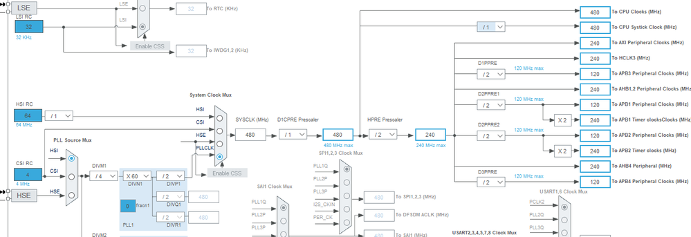

I am trying to set the clock frequency to max of 480 MHz. I tried 120 MHz and there is not problem with that. The block code is very similar for both, so not sure what is going wrong.
I feel the oscillator fails and goes into an error state.
Based on datasheet max speed is 480 MHz and PLLM, N, Q are set based on valid values taken from CubeMX.
I also tried all possible value for "FLASH_ACR_LATENCY_15WS" since this is the only difference between 2 code blocks of 120 and 480.
Here is USART output:

2020-11-16 7:10 AM
Thanks! It worked after making bellow modifications.
Here is my findings:
1.Bellow config is a must as you mentioned
2.Bellow is also a must when configuring the PLLM, N, Q
3.It is better to add bellow 2 lines as well to the clock config
Here is the complete working code. Changes were only made to "SystemClock_Config"

Try using the code generated from CubeMX. You need to do more than just PLL settings to go into 480MHz mode.
2020-11-16 7:10 AM
