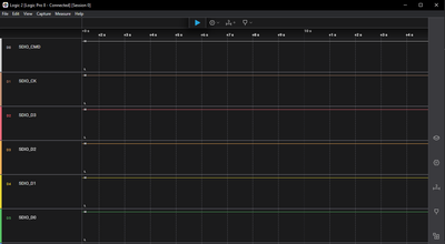

I have been trying to get SDIO working (4-bit) using STM32CubeMX and a NUCLEO-F401RE dev board. I am using the Adafruit SDIO breakout board here: Adafruit Micro SD SPI or SDIO Card Breakout Board . Unfortunately, no matter what I change in the code or in the CubeMX software I can't even get a single clock pulse or blip on the data lines. The output on my logic analyser has absolutely no activity.

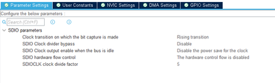

*Note: I have a SDIOCLK clock divide factor of 5 (12MHz) currently on the SDIO config page (I have tried 12 as well to bring the SDIO clock down to 6MHz)

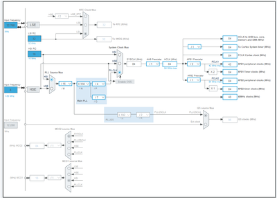

I have recently found while digging through many of the SDIO related posts on this forum is the RCC configuration might be wrong... I am using the Nucleo board which doesn't have crystal X3 installed. From what I can tell I need to have HSEON enabled as well as the PLL to get SDIO working. However, other peripherals sharing the APB2 peripheral clocks seem to be working fine (I have a SPI TFT LCD that works fine). I know something is clocking for the LCD to work on SPI1 so I would expect something on the SDIO bus). My RCC config is here:

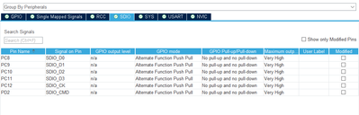

I also think SDIO is correctly configured in GPIO:
*No pullups because there are 10k pullups on the CMD and Data lines.
And finally, I think SDIO is also configured alright?

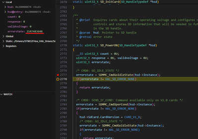

If I step into the code, the errorState comes back non-zero from SDMMC_CmdGoIdleState. Since nothing is written, nothing is sent, which results in an error.
failure point in stm32f4xx_hal_sd.c
If I had to guess I am not initialising something correctly so nothing can be written to or read from these data/cmd/clk lines. SD_DETECT is high when an SD card is inserted, low when removed.
