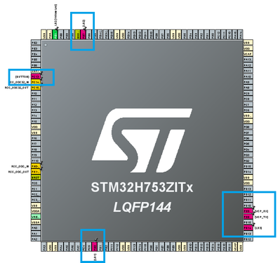

I do not use PD8/PD9/PB0 pins in my design. Therefore I did not configure them in CubeMax.
Why NECLEO-H753ZI CUBEMX Pinout View PD8/PD9/PB0 pins are in RED?
Thanks,
Peter

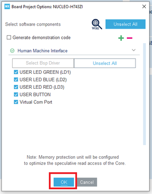

All these pins are colored in red because you started your project from the board and you selected at the beginning to intialize the BSP:
You've clicked OK:
So you get:

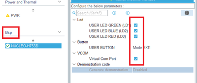

To disable these IOs, go to Bsp tab and uncheck all these checkboxes.
Hope that answres your question
