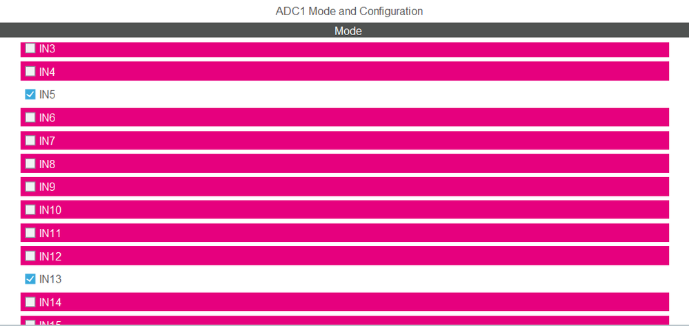

Hello, I am working with the STM32F429-DISC1 development board. I am trying to read two adc from one channel. I can't read the code that I could read in the past. The code that worked in the morning is not working now. I may have changed a little. Please help me. My code is at below:

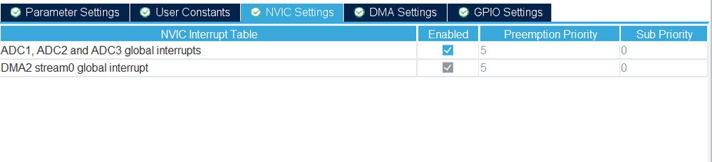

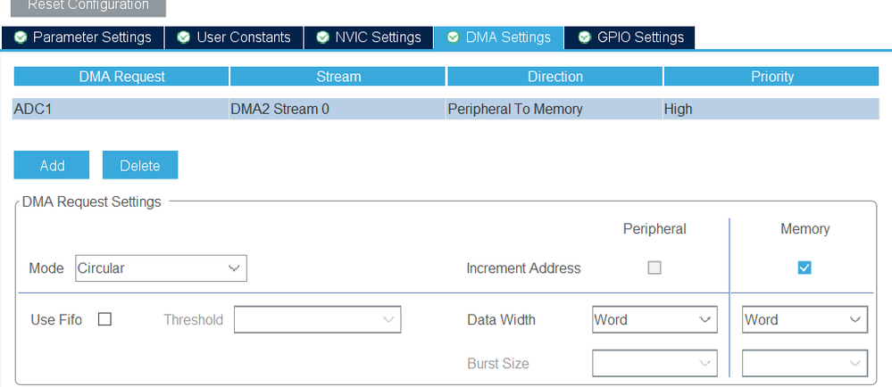

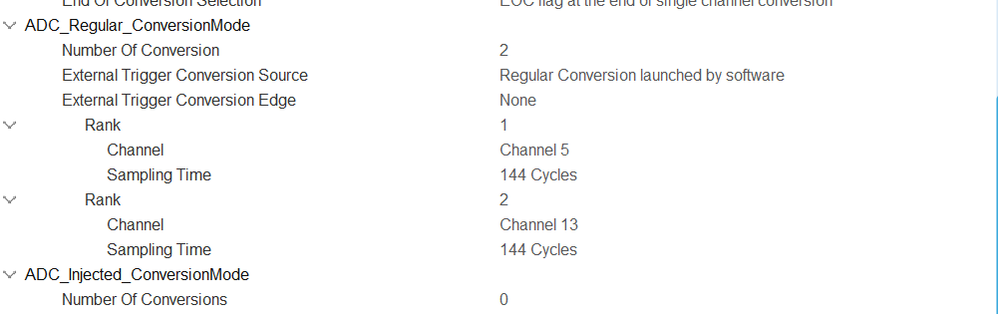

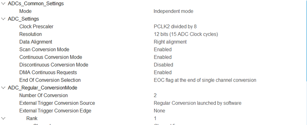

Differences I have seen with the F429DISC1 HAL Library ADC DMA example:
Scan Conversion Mode is Disabled
End of Conversion Selection is Disabled.
Did you modify one or both of those?
Insert a breakpoint in the void HAL_ADC_ConvCpltCallback(ADC_HandleTypeDef* hadc)
function to see if this gets executed. If it doesn't, an ADC1_DMA_IRQHandler interrupt handler may be missing.
2022-10-05 2:51 PM
I was reading adc values with same setting, ı dont know why this is happening.
