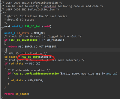

2025-01-11 2:50 PM
It's done in the BSP initialization here:
2025-01-11 2:43 PM

2025-01-11 2:50 PM
