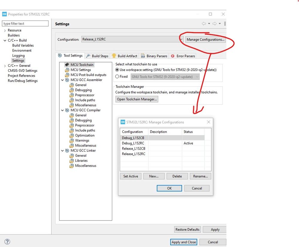

2021-10-04 8:32 AM
Update. I was able to get it working. I created targets first (debug and release for my second target, based on those of the first target). Then I manually edited the processor references in the .cproject file. I changed STM32L152xC to STM32L152xB. I changed STM32L152RC to STM32L152CB. I changed the flash load file. I had to add one header file: stm32l152xb.h and one load file: STM32L152CBTX_FLASH.ld.
Unfortunately I cannot change the output folder path or name as this is determined by eclipse. I've read that using makefiles that would be possible, but after struggling with getting those to work I gave up.
I renamed to .ioc file to .ioc.bak so I wouldn't accidentally overwrite the files. When I need to make a change I rename it back to .ioc, make my changes, rename back to .ioc and revert unwanted changes in git such as to the .cproject file.

I think you are right. I will use the code generation once and then manually merge them and then just archive the config files. If I need to make changes then I just need to generate again and manually merge. Shouldn't be too much work. The only issue is how to set multiple debug targets in eclipse, but I think Cartu38 OpenDev can help with that.
2021-10-01 8:57 AM

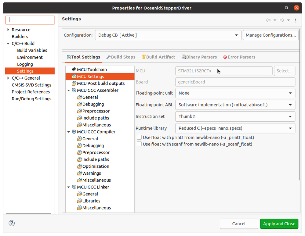

I will try to implement your solution. I will just manually merge the source codes and change the eclipse project build configurations.
I have a question. The MCU is greyed out. How can I change it? I manually changed the device defines in GCC/preprocessor and MCU G++/Preprocessor, but that didn't change the MCU.

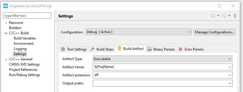

2021-10-04 11:27 PM
1) If Keil such proposal is pure IDE ... STM32CubeIDE is promoting you device configuration and related code generation as addon ... it comes with obvious pros but some cons.
2) Output file name is up to you so you can set one per build configuration if you want
2021-10-04 11:35 PM
Updating target device is not possible wihout hacks ... but such are fairly obvious and safe.
Either edit .cproject file you'll see one target device reference per build configuration ... just edit it. Or remove <nature>com.st.stm32cube.ide.mcu.MCUProjectNature</nature> from .project file then build settings are enabling device target selection.
Kind reminder, doing hacks your are self responsible about .... some target device is part too of .ioc file .... but can fly depending what you're doing. High level hacking metadatas is bad practice bt may help from time to time.

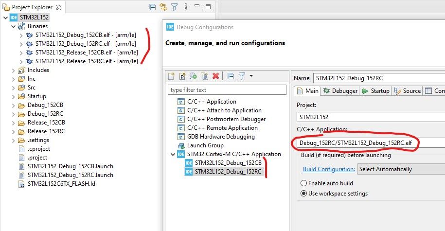

2021-10-05 7:37 AM
With output folder I mean the folder with all the build artifacts. That folder always has the name of the build configuration.
Thanks for the tip of removing the line with MCUProjectNature. If I knew that beforehand I wouldn't have to manually edit the .cproject file. It works!
Now I can build and debug all build configurations (both targets in debug and release). The only issue I have right now is that I have to manually select the correct launch configuration per build configuration. I wish I could connect specific launch configurations to build configurations. Since each build configuration has its own folder with build artifacts and elf file I need multiple launch configurations to point to the different elf files. If you know a way you would make me happy.
2021-10-06 12:12 PM
About build config vs. launch not sure about your trouble.
You mayhave one launch per build artifact or one single launch on which you select prior start binary you are pointing to
