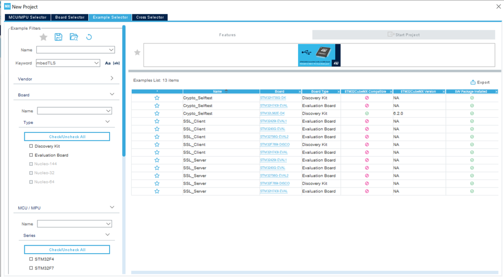

Unfortunately, MQTT cannot be configured through STM32CubeMX interface. However, preconfigured projects based on mbedTLS are available through STM32CubeMX > Example selector. They may be handy to correctly configure and work with MbedTLS:

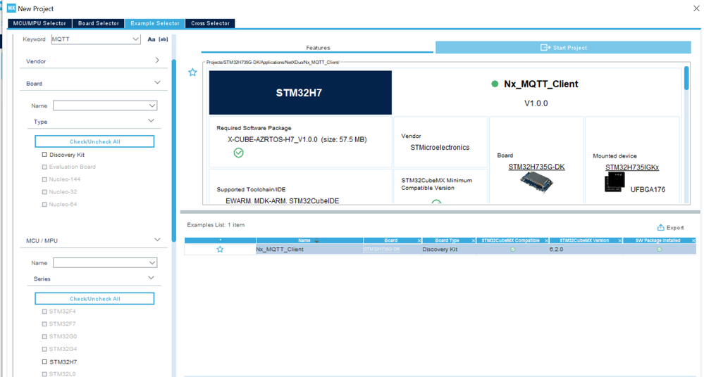

Furthermore, X-CUBE-AZRTOS-H7 is delivered with Nx_MQTT_Client application running on STM32H735G-DK board. This application provides an example of Azure RTOS NetX/NetXDuo stack usage . It shows how to exchange data between client and server using MQTT protocol in an encrypted mode supporting TLS v1.2.
It accessible through Example Selector of STM32CubeMX:
It may be a good orientation for you to develop your project.
