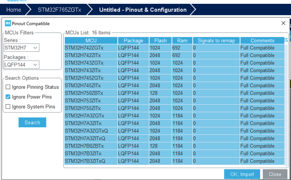

Thanks @TDK , I tried with STM32CubeMX standalone version and "list compatible pinouts" feature was available.
However, unfortunately I couldn't find any H7 pin compatible with STM32F765ZGT6-LQFP144 even when I ignored power pins or other options! I'm 100% sure two years ago when I was designing this hardware I could find a pin compatible H7 version of this microcontroller. At that time I wanted to keep the option of using higher performance microcontroller for future. But right now it seems that I can't find any H7 microcontroller for this purpose!!
Do you have any suggestion?
2020-11-12 2:31 PM
This suggests pin-to-pin compatibility on LQFP144.
I see many options. I checked one, which appeared valid. Unchecking "Ignore Power Pins" seems to erase all results, not sure why.
