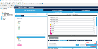

Thank you.2024-03-12 2:07 PM
"Add IP Handle Label"
