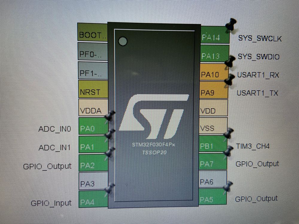

maybe pictures of your board or code would help

2019-11-27 4:19 AM
you can see the picture , now pwm out is PB1
but i want switch to PA2

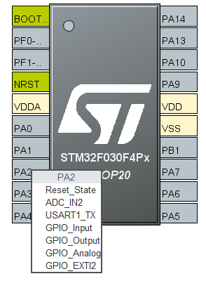

there is no PWM functionality in PA2.
PWM functionality is a feature some specific pins have, (because they can be connected to the timmer pwm outputs).
If the pin you want to use doesnt have that access to the pwm timmer function you need to create your own pwm thing.

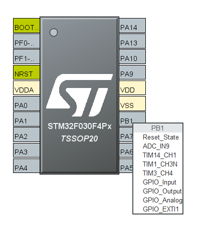

you can see the functionalities of the PB1 or PA2 pin if you leftclick on it.
PB1 has the Timmer channel 1 functionalities (like pwm and more)
PA2 is only linked with ADC, UART, and GPIO functionalities
