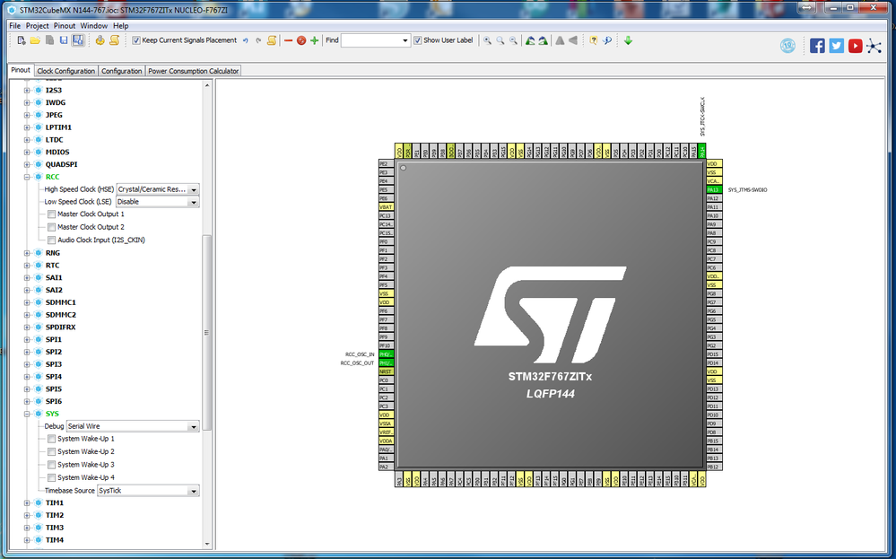

You didn't show the pins page, but i assume it looks like this;

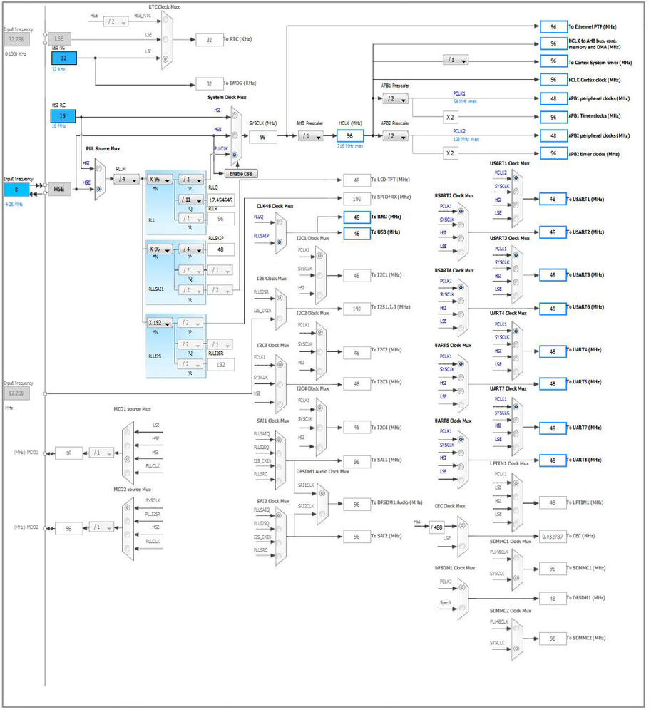

My project is absolute min changes to get project running.
Set RCC pin outs as shown.
In clock setup, set hse input freq to 8mhz, choose hse radio buttons, entered hclk of 96mhz, hit enter to let cube solve the rest.
one dif is the line;
RCC_OscInitStruct.PLL.PLLQ = 2;�?�?�?
