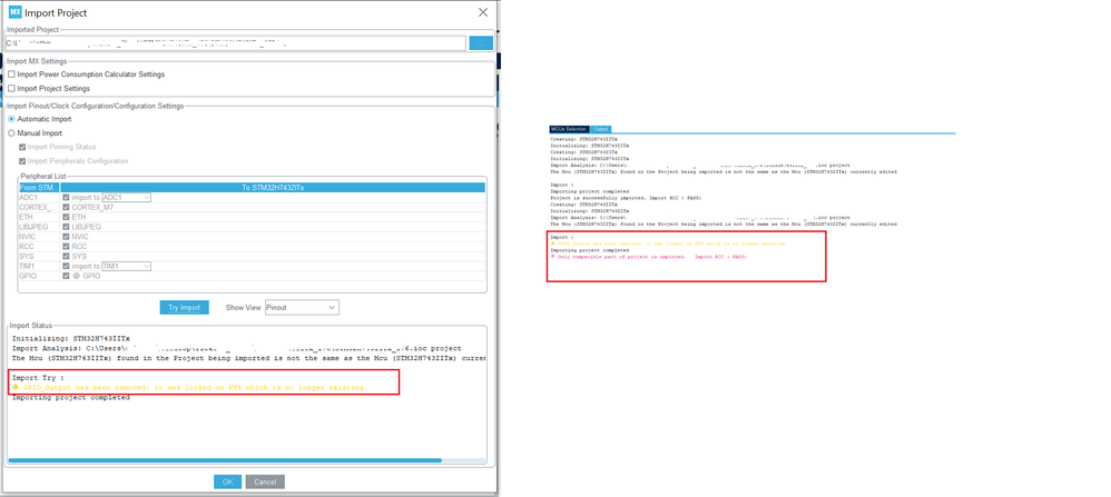

In fact, STM32CubeMX allows loading a project configuration on an MCU of the same Series ( no matter the package). When importing your project, a message warns you that the currently selected MCU (stm32743ZIT; LQFP package with 144 pin) differs from the one specified in the .ioc file (stm32h743; BGA package with 176 pinout) and several import options are proposed (Automatic project import or Manual project import).
Actually I have tried a simple use case from my side, trying to import a project created with STM32H743IITx MCU to the STM32H743ZITx (in my case PH4 was assigned to GPIO_Output). Thus, a conflict occurs and a cross sign indicates that there is a pinout conflict and that the configuration can not be imported as such:
Moreover, when generating code for the imported project I cannot find any code section configuring/initializing port H. Only configured GPIOs are initialized.

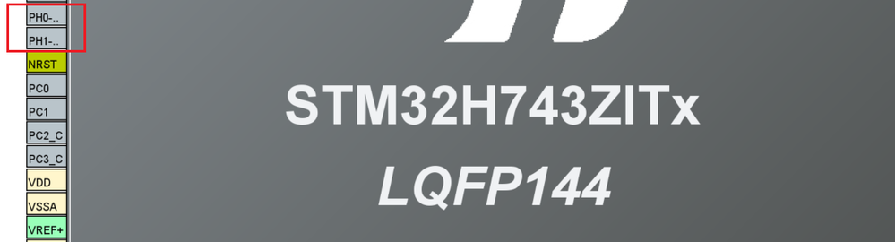

Furthermore, focusing on STM32H743ZITx MCU pinout view (as well as STM32H743xI Data Sheet Table 9. Pin/ball definition), PH0-OSC_IN(PH0) as well as PH1-OSC_OUT(PH1) pins are available in all packages including LQFP144 :
Your feedback is important to track the root cause of the issue.
