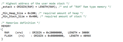

Hello @SteveM732
I've opened a project based on your .ioc file on the STM32CubeIDE V1.18.0 and I've been able to find the correct RAM value. Could you send me a screenshot of the error with the last CubeIDE and MX versions.
Best Regards.
STTwo-32

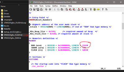

2025-04-11 10:37 AM
2025-04-11 11:12 AM
I've seen the same behavior, and I've reported to the concerned team for correction on the future (under internal ticket number 207481). Thank you for reporting this.
