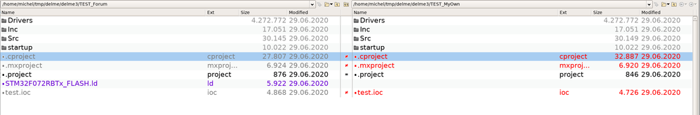

2020-06-29 8:35 AM
That's really weird !
I just downloaded your TEST folder, copy the test.ioc to a new folder, open it in STM32CubeMx and generate the code.
==> no linker script file
Here are the differences:
But:
Please see attached the generated files out of your test.ioc for details.
I think the issue is not related to a F0 device.
Had chosen also a F103 device and Eclipse showed a misbehavior in handling the project) - but I have to cross check this again.
Thanks for your feedback.
