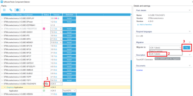

Don't know if you have used the version 4.24.0 before, but try to set the TouchGFX version from "Select components":

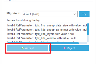

Finally, accept the migration:
At this stage TouchGFX V4.24.1 is set to your project.
Hope it helps.
