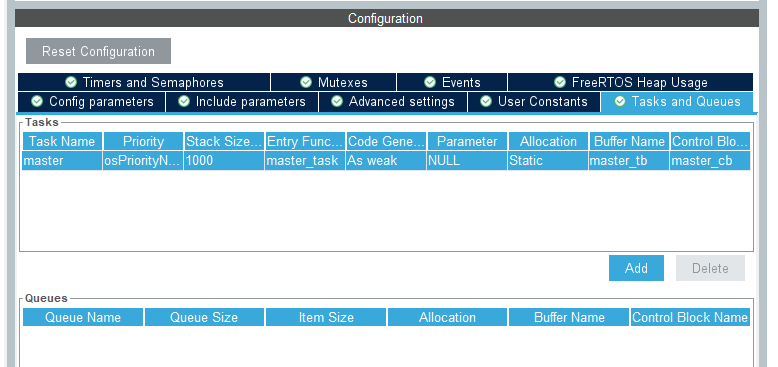

Hi, I use the latest version integrated in cubeIDE not stand alone cubeMX, but I assume is uses common framework. Here is the picture with single task that can not be deleted.
0693W00000SuUTcQAN.pngIn generated code I can put the #if 0 to prevent to remove the task from being created. Because it is in used code section it will survive the regeneration. However it is completely dependent on generator template which can change with any update so it is no way a solution of the problem. Just a hack for of current version.
