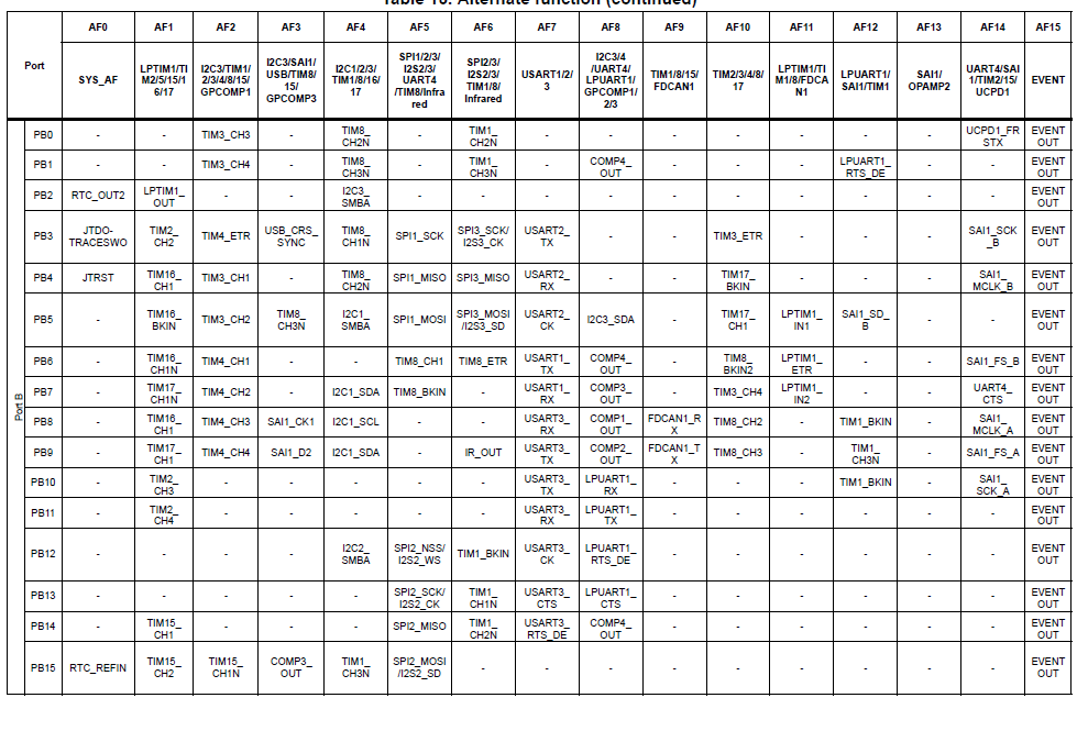

I have a Custom PCB with two STM32G4 communicating over SPI, by mistake I have connected PB4 coming from the master device to PB5 on the slave device , and now I am just wondering if it is possible to remap those two pins, according to the datasheet it does not look promising.
As shown here: PB4 has to be SPI_MISO and PB5 has to be SPI_MOSI.

No, unfortunately no chance to exchange the pins internally.
BTW: when looking for a possible solution, it is always a good idea to include the necessary details, in this case e.g. that you are talking about an STM32G431.
Good luck with rewiring the pins externally!

If speed allows, use bitbanging SPI.

You can use BIDIMODE, although it's quite a PITA... :)
