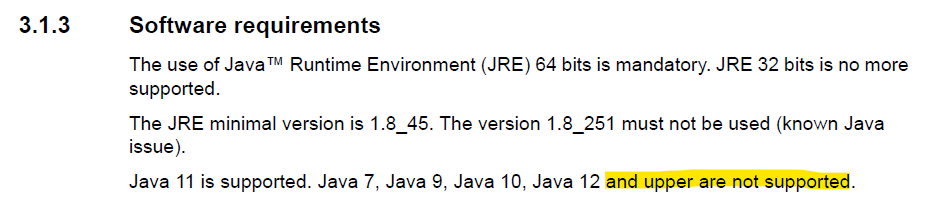

Hi @Grozea.Ion
Thanks for the feedback, please check your JAVA version.
if the problem is with java version, please try to go back to another JRE version (e.g Java 11 or Java 8)
Best regards,
Nesrine
