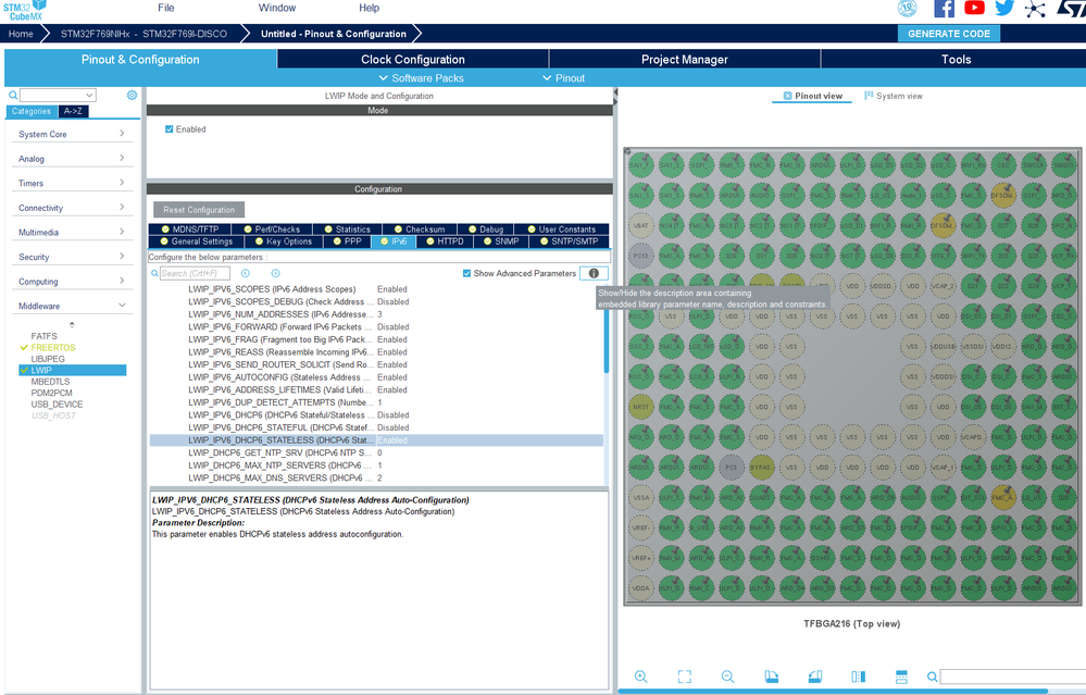

After creating a project using the STM32f769Ni discovery board, and activating LWIP through the component list, in the displayed Configuration tab there is window tab named IPv6. From IPv6 Configuration tab you can enable IPv6 protocol and set all other IPv6 options (All IPv6 options are visible when checking "Show Advanced Parameters" checkbox). LWIP_IPV6_DHCP6_STATELESS parameter enables DHCPv6 stateless address autoconfiguration .
Below is a screenshot to make the process clearer.
