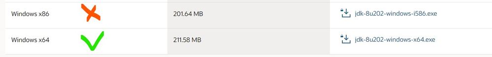

Can you please follow theses steps:
1- Remove you current JRE from Windows
2- Download the JRE 64-bit (Offline installer package), through this link
3- Install STM32CubeMX
I'm waiting for your feedback,
Aymen.
2020-08-25 1:44 PM
Hi! Aymen,
I've installed ST32CubeMX successfully based on your link. This Java works.
Now www.st.com web site also works regularly.
Thanks for your support.
Regards,
Adam
