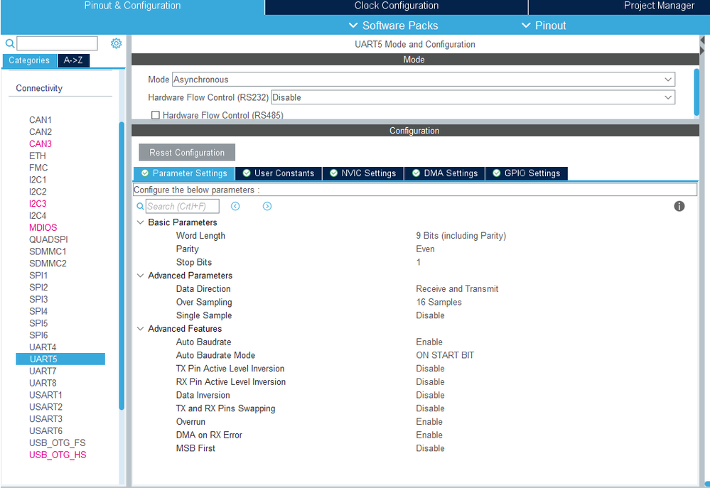

I generate code for stm32f767. I use software package 1.16.0 I want to use UART5 in auto baud mode via 0x55 symbol. And USART3 the same. Why code is different?

Now I use pack 1.16.1
and I try to use UART5 on my stm32f767
I select autobauderate:
Than I connect stm32f767 to my uart device with 9600 baud. I transmit 'U'. But I am going to Error_Handler.
if (__HAL_UART_GET_FLAG(&huart5, UART_FLAG_ABRE)!= RESET){
Error_Handler();
I try to understand what happend and I find MX_UART5_Init with
huart5.Init.BaudRate = 115200;
Yes, I did not set baud! Why CubeIDE generate 115200? And why it is important? When I set 9600 on my prog no Error_Handler()!

I also find very interesting code in stm32f767xx.h. Does UART5 support auto baud? How check it? I can't see list of supported UART in stm32f76xx datasheet and AN4908 Rev 2 is very old (no stm32f767)...
/****************** UART Instances : Auto Baud Rate detection ****************/
#define IS_USART_AUTOBAUDRATE_DETECTION_INSTANCE(__INSTANCE__) (((__INSTANCE__) == USART1) || \
((__INSTANCE__) == USART2) || \
((__INSTANCE__) == USART3) || \
((__INSTANCE__) == USART6))
