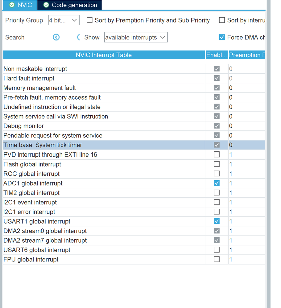

I would need to use the HAL_I2C_Master_Transmit function in an ISR, in particular I would like to use it in the HAL_ADC_ConvCpltCallback function.
I have seen that the HAL_I2C_Master_Transmit function calls HAL_GetTick() so I set the interrupt priority of Tima Base: Syste tick timer to a higher priority than all the others interrupts, but the HAL_ADC_ConvCpltCallback function stops when HAL_I2C_Master_Transmit is called.
Can anyone help me?
This is my NVIC configuration:

2021-12-10 2:29 AM
I tried to do the same test with a simple HAL_Delay () in the ISR routine. And it stops when the function HAL_GetTick() is called.
I've seen dozens of posts asking for the same issue, but they all say that just apply a higher priority to the SysTick interrupt to solve, I don't understand why it doesn't work in my case.

2021-12-10 5:32 PM
As you see, at least half of advises is "just do not do blocking calls in ISRs". Delay to the main loop or a task.
