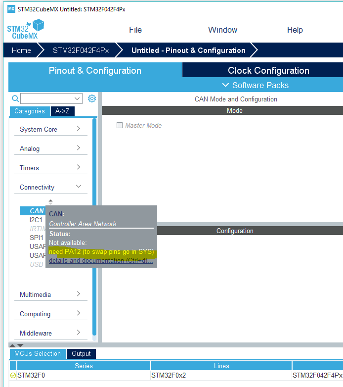

I would like to use an STM32F042F4 MCU with CAN communication. I saw the CAN bus in STM32CubeMx by Connectivty, but i can't select it (it is grey)? I read in the datasheet of the MCU that i have to remap CAN bus pin to PA10 and PA9.
Can you help me, how can select CAN bus in STM32CubeMx?

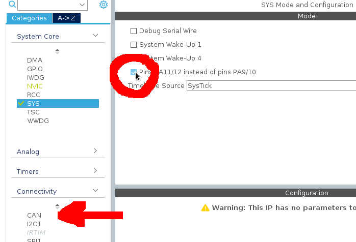

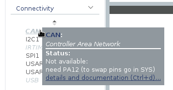

Let the mouse pointer rest a bit over the grayed-out CAN peripheral.
Now go to SYS as advised to swap the pins
and CAN is no longer grayed out.

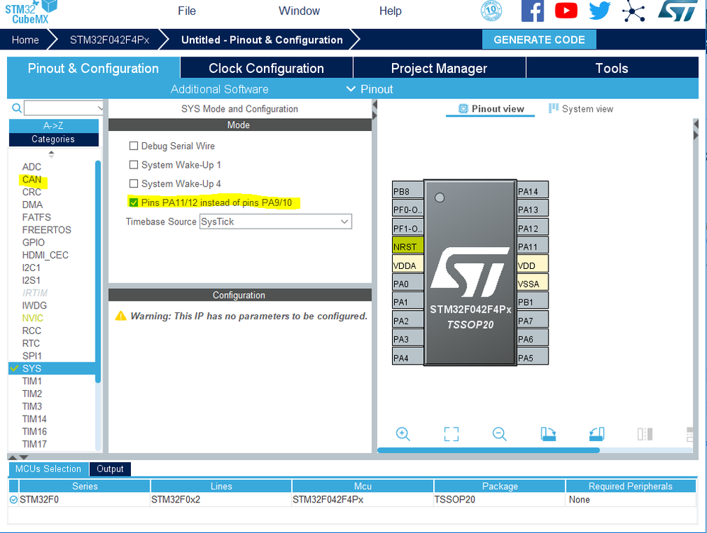

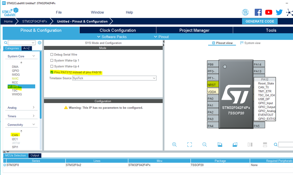

Hello Bence Stocker,
In order to activate CAN bus in STM32CubeMx when working with STM32F042F4 MCU, select SYS from the the component list and then check "Pins PA11/12 instead of pins PA9/10" in "SYS Mode and Configuration" panel, CAN bus will be automatically available and you can select it.

Hi @Bence Stocker
You need PA12 (to swap pins go in sys): go to sys then select Pin PA11/PA12 instead of pins PA9/10
