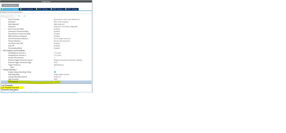

I've a question related to how AWD works in case of STM32G030 controller. As per my understanding, AWD analog watchdog status bit is set if the analog voltage converted by the ADC is below a low threshold or above a high threshold. These thresholds are programmed in the 12 least significant bits of the ADC_HTR and ADC_LTR 16-bit registers. An interrupt can be enabled by using the AWDIE bit in the ADC_CR1 register.
However, STM32Cube IDE doesn't allow to configure low threshold value other than 0 and according to parameter description "low threshold value must be set to 0". In that case how STM32G030 generates an interrupt if it goes below 2.5V?
2021-08-10 8:37 AM
Seems like it's a CubeMX bug. You can adjust the lower threshold on AWD 2 and 3, but the UI tries to be smart and won't let you set LT above HT, or HT below LT. Maybe the AWD 1 HT field is missing an event which updates the range of LT.

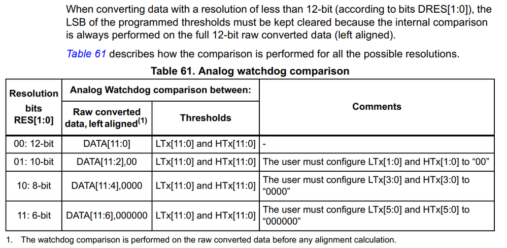

It seems that some restrictions related to thresholds setup for analog watchdog 1 are wrongly implemented. The implementation has to be aligned with the description provided in the table "Analog watchdog comparison" of RM0454.
In this table, we see that values of LT & HT depend on the resolution, mainly when it is less than 12-bit:
That conditions aren't applicable for AWD2 & AWD3, that is why there is no such issue for both ones.

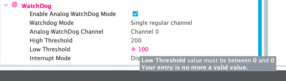

I created a new example project where I manually edited the ioc file to set the ADC low threshold to 100 as an example: https://github.com/Durza007/awd_low_showcase/blob/main/adc_low.ioc#L5
If I open that file in STM32CubeIDE v1.11.0 with STM32CubeMX v6.7.0 it gives me an error that the value is invalid, see attached image below.
Is this working as it should? The low threshold does seem to work as it should when running on the actual hardware so I think the UI is wrong here.
