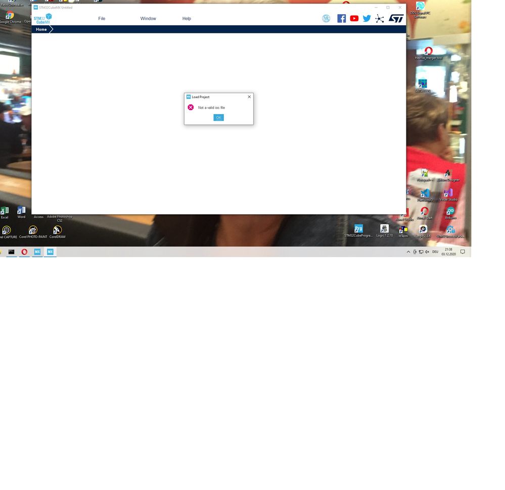

I reinstalled CubeMX yesterday but got the same result. I also make a new project in a directory without spaces (test), the same result. I installed the latest Version of Java and deleted the "old" Java installations with the Java Removal Tool, still the same result.
I tried to open an "old" project, the same error message.
I hope you can help me. Thanks and best regards
Guenther

thanks for your support.
The problem started yesterday when I started a new project. When I started CubeMX, an upgrade was downloaded. I had previously worked with version 6.0.1, the upgrade was to version 6.1.0.
I want to replace an older design with an ATMEL 8-bit processor with an STM32F030. For first attempts I wanted to use the STM32F0 Discovery Board.
When I had defined the pins, I realized that the USER_Label for the pins could not be edited. Then I had the source code generated for the project. That still worked well, but when I tried to open the project I received the error message.
Then I uninstalled CubeMx and installed version 6.0.1. Unfortunately, I still got the error message. My next step was to delete all "old" Java installations and install the latest version. After the Java installation I installed the CubeMX 6.0.1 again. No improvement.
I only use CubeMX for configuration and code debugging in GUI mode.
I have now used STM32Cube FW_F0 V1.11.1 before generating the code after your reference. The code generation works, but the project cannot be opened afterwards.
I looked at the ioc file with the editor (NotePad ++), the XML file looks "normal" to me. However, I haven't changed anything about it.
When uninstalling and installing CubeMX, I noticed that the project information was not lost.
Can you tell me which directories are to be deleted after the uninstallation, that CubeMX is completely deleted or which entries in the Windows registry are to be deleted. Maybe something is broken in a "hidden" directory or file or registry key that causes this error message to appear.
As I have already written, older project files can also not opened. I also get this error message with these previously working files.
Thank you for your help.
Best regards
Guenther

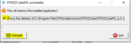

2020-12-07 2:55 PM
Hello GKrei.1,
Sorry for the delay.
I can't reproduce the issue even when trying to do the same steps detailed in your comment above. It is weird that you're facing this issue and I can't assess it is an upgrade issue since in both case :
I' m not facing any problem with opening any .ioc saved in my machine .
In this case please retry to uninstall all the old CubeMX versions in your machine (check "Force the deletion" box) and verify that CubeMX is completely deleted.
Hope this will help you,
Khouloud.
